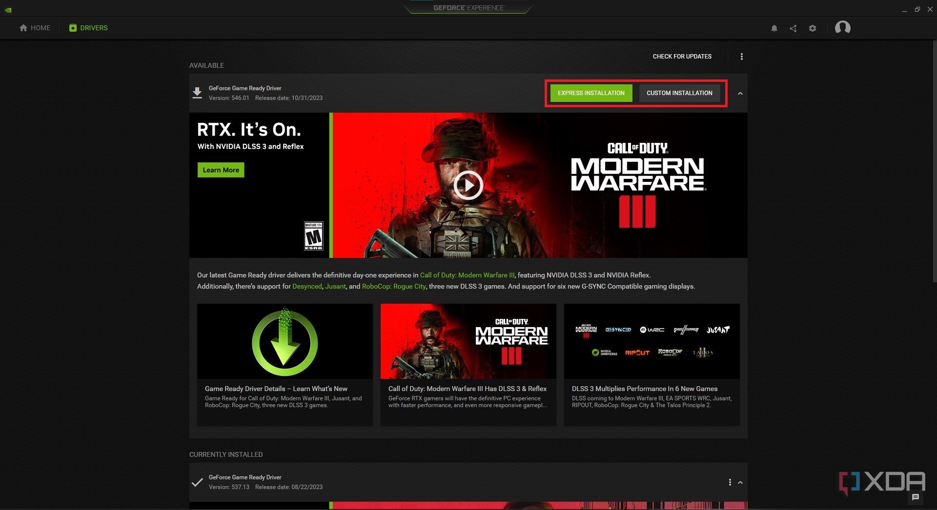

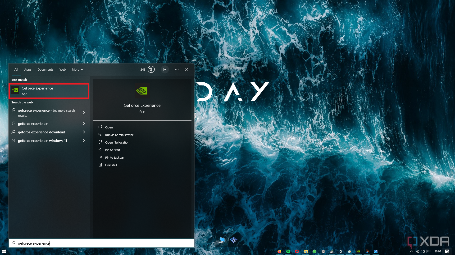

For your GPU to function properly, you need a working set of drivers, preferably the newest ones. Updating your drivers is easy for both Nvidia and AMD GPUs, but it requires their discrete applications. For Nvidia users, you should have GeForce Experience, and for owners of AMD graphic cards, AMD Radeon software is the way to go. The process is essentially the same for both software, but we’ll be taking Nvidia as an example. Here’s how you can update your GPU drivers:
  1. Open GeForce Experience if you already have it installed. If you don’t, it’s best to install it as it can help automatically update GPU drivers.
  2. Up top, you’ll see the Drivers section. Click on it.
  3. Here, you should see a new update for your Nvidia GPU. If you can’t, then click on the Check for Updates button, and if you’re still running an older driver version, a new version should show up. Click on the Download button and wait for it to download.
  4. Select either Custom Installation if you want to do a clean install or Express Installation if you want to install the update as soon as possible. Follow the instructions and wait until the update is installed, and you should be good to go.
Your screen might flash a couple of times during the installation, which is normal, and nothing to worry about. After the installation is complete, restart your PC and check whether your GPU has started working or not.
