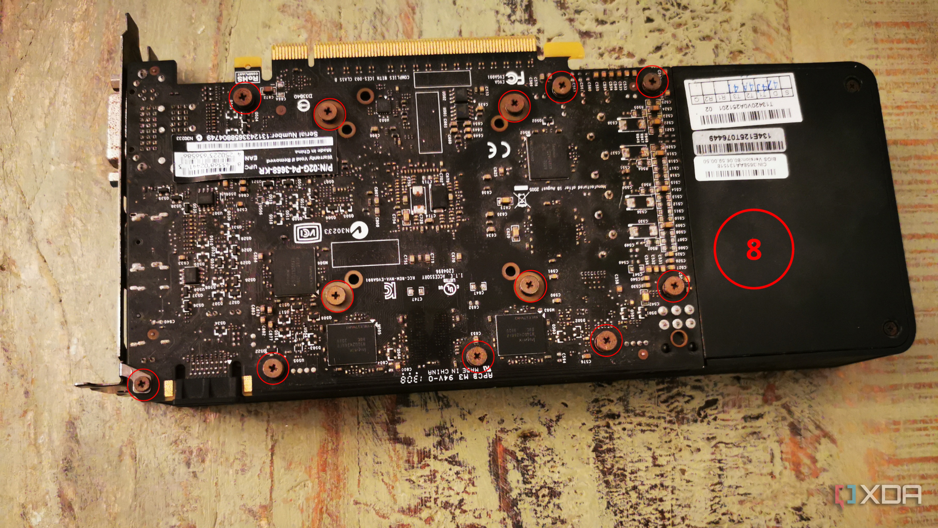

    3. Unscrew the back panel of the graphics card.
    4. Unplug the fan power cable and separate the GPU from its heatsink.

    8. Screw in the back panel to reassemble the GPU.

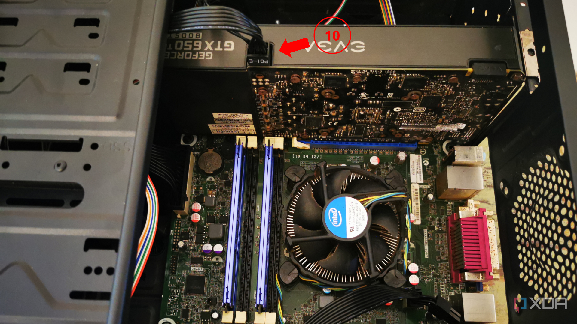

    10. Plug the PCIE power cable into the GPU.
